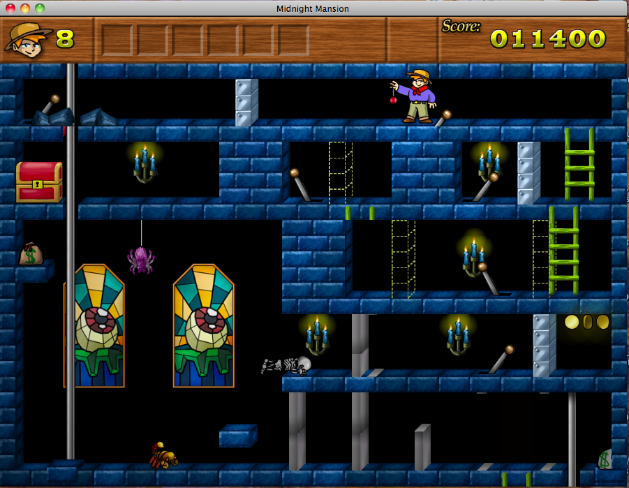

Re: Luris for HD - rose - 12-15-2012
I am testing Luris HD. I found that Jack can't slide down the pole where he is standing in the image.
Re: Luris for HD - rose - 12-16-2012
Here is another problem and I can't continue the testing until this is corrected. The lever where Jack is standing is to low. He can't pull it.
Re: Luris for HD - RobSeegel - 12-16-2012
514C5046230 wrote: Here is another problem and I can't continue the testing until this is corrected. The lever where Jack is standing is to low. He can't pull it.
Yes. Thanks i missed that lever. So, what do you think? Does the new lever image look reasonable? It's close to the same look as the
buried
levers. Too bad you did not have the room number displayed for that room.
Compared to the same lever in the original mansion it is placed a little low. I checked that out in the Mansion Level Builder. Jack ca't pull it as it is now.
617C6076130 wrote: Compared to the same lever in the original mansion it is placed a little low. I checked that out in  the Mansion Level Builder. Jack ca't pull it as it is now.
That's not what I meant. Yes, that particular lever is too low, because initially nearly all the levers in this mansion were
buried
. To hide the lever's base, they were moved lower. So, I went through and raised the levers up so that they could be used and replaced the lever graphic with a custom one so it
looks
as though it is protruding from the ground. I must have missed that particular lever. That lever is actually in the same position as in the original, but the modified lever graphic makes it look lower.
Re: Luris for HD - rose - 12-17-2012
I so totally misunderstood your question. I really can't see any difference between these levers to any other levers.
Room number is 11502.
