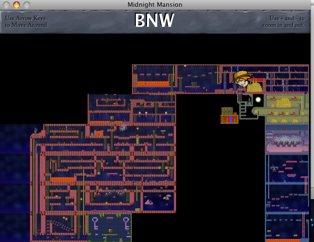

Here is my Jack in 16293 before ever going up to 16093. You can see he has 39 secrets but the sign in the room above says only 38.
Maybe you changed something in some area after my Jack was there? Thus removed the extra secret that my Jack has got? To check that I would have to restart from the beginning and my jack is not in the mood for that until he has finished the mansion.
Now he is off for the missing yellow key ...
One more thing about 16093:
It seems to me that Jack is directed to go to the next room to the right rather than going up.  Is that the intention here?  Will anything weird happen if he begins with going up from 16093?
Let's find out ...
Impossible. If Jack does the topmost brown area first and then goes down from 15697 to 15897 he has no way to go from 15896 to 15895. He can of course go to the exit but cannot finish the mansion and has to restart in room 16293
As far as I can see, Jack has done everything he can possibly do before going to the brown area. See map.
But there are no hints that tell him that he has to retrace his steps to 16093 to be able to go on.
If Jack discovers the secret exit in 16093 prematurely and immediately goes up to the brown area he will reach a dead end and has to reload or exit the mansion.
If Jack does not discover the secret exit and starts by going to the right from 16093 he ends up as my Jack now not knowing what to do next. He needs an extra hint about what to do next.
59495E57573B0 wrote: Here is my Jack in 16293 before ever going up to 16093.  You can see he has 39 secrets but the sign in the room above says only 38.
For that reason alone you don't need to replay the whole mansion again. But you may check your amount of secrets at previous saves.
Thanks for being so alert during the testing. Somewhere in the past the situation was that it didn't matter if Jack went first right or up in room 16093. But later rooms changed or got added and the link back got broken.
Right now I am working at an update for this and a subtle hint for the brown area. Then tell me if it is enough.
