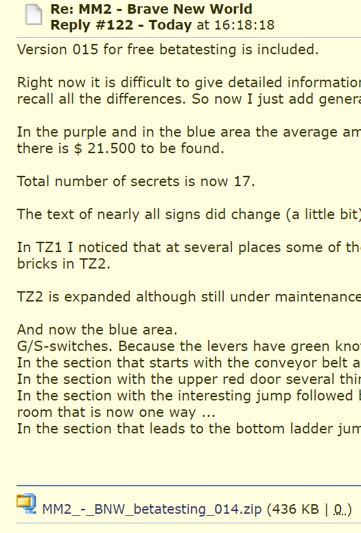

See the bottom line on the image. How confusing.
I did add the zip file for version 015 and you may get the impression that I added the previous version. Due to the system of the software.
My given name of the added zip was:
MM2 - BNW betatesting
. By coincidence it is the 14th time that a file was added to the boards with that same name. And that is why the boards automatically did add the suffix 014.
It is what it is. But I just wanted to assure that the attachment really is 015.

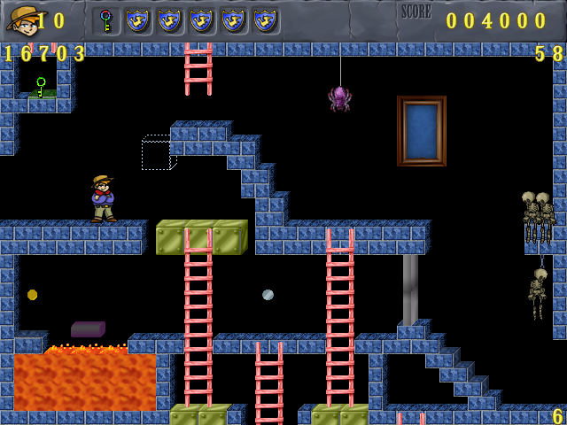

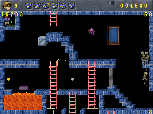

I did find a way to keep the green key in the lower room. See pic 16703a. But this area is really cursed. For the first time I encountered an important shield problem.
Time line:

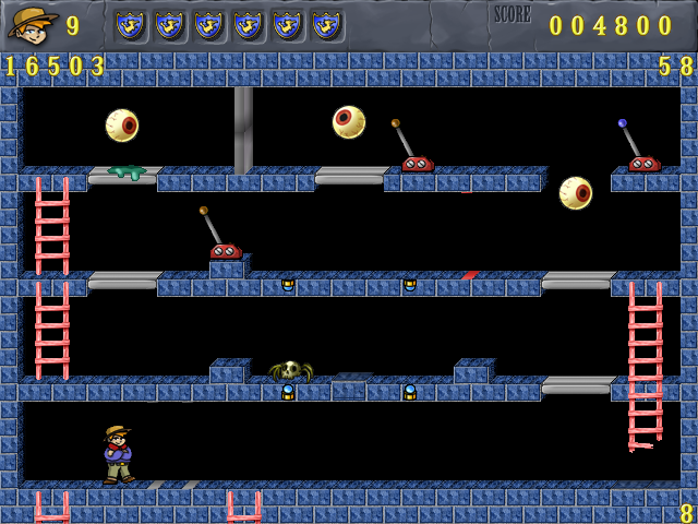

1. After arriving in TZ1 Jack chose the blue section with the upper red door to do first of all (pic 16703 a).
2. Jack entered with five shields.
3. In 16503 he opened the red door.
4. He filled his backpack with shields (pic 16503).
5. Jack went down and changed gold into silver but couldn't pick up the green key (pic 16703 b).
It is easy to get rid of a shield in the room above, but I need to accept that it is possible that Jack may continue back to TZ1 with his six shields. Well, that is nearly a Jack-stuck because all other blue sections are 'closed' as well as TZ2 (and the way to the exit). The only thing that rest is going up again to the purple section to change the blocks back to gold. A quarter of an hour backtracking ...
Shocked Shocked Shocked
I fixed it by removing the two shields in this blue section. But, after this experience, I absolutely need to do severe shield-checks in the other blue sections.
