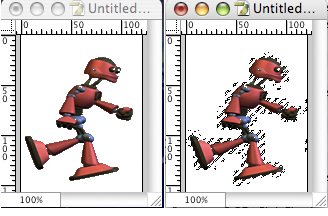

Joes TIP #1:
White is not always white.
Whenever you have a raggy edge the first thing you should do is go into PS, open the source document and select the magic wand. In the toolbar, in the tolerance box type a 1 (one). Click anywhere in your document and if there's nonwhite pixels you'll see them! To work correctly
WHITE = 255,255,255
AQUA = 0,255,255
BLACK = 0,0,0
Just because you can't see the difference between a white pixel at 255,255,255 and a "white" pixel at 254,255,255 the software will put that white pixel up and you'll scratch your head and go "Wait, that pixel is white". TOTOMB I ran into that issue with the plants where there were pixels at 0, 254,255. See the attached example.
HTH,
Joe B

Thanks a lot, Joe.
My dancer looked exactly like your JAC in the right picture !!!
I have tried it out, now, and it really works.... but it's pretty hard work, nevertheless.
I assume, by "Magic Wand" you mean that "magic eraser" in Photoshop (I have the german version)?!  I used that now, and it worked good, however -even with the tolerance set to 1- the radius of it was sometimes too big, and it started erasing non-white pixels that were actually part of the picture. The reason for that is that the picts are pretty low res, so the borders are often not "defined enough".  Next time I will do that process while the picture is still at a higher resolution and bigger size, and only downsize it AFTER this process is finished !!
But I managed to include the finished dancer in my mansion and it looked really good for the first time. Thx a lot.   Smiley Cheesy

NO. The magic wand is the tool that looks like a wand with a sparkle at the top. On most versions of Photoshop/Elements it's the second tool from the top on the right hand side of the tool palette. For any MM work it is INVALUABLE! Using that same technique of select everything on the white background you can then go to the Select menu and choose Inverse. Now you'll select everything that isn't white which should be you graphic. Using the same Select menu you choose Modify -> Border and in the dialog box select 1 pixel. Now you have an outline around your object. Then you can do a fill with whatever color you want, black in most cases. Then you can touch up the outline by hand. I'll see if I can put together a step by step with graphics explaining what I mean. As I said above this is THE tool you really want to become familiar with.

Oh you mean the "Zauberstab" (that's the german expression for it in Photoshop). I was confused, as "wand" in german means wall, and this thing looks nothing like a wall !!!  Smiley
However I use this thing usually only for selections, to easily select a region.... I never knew it had other uses as well...
But I managed to use the magic eraser for that purpose as well, with the limitations I described above.  So I will now try it with the Zauberstab.
